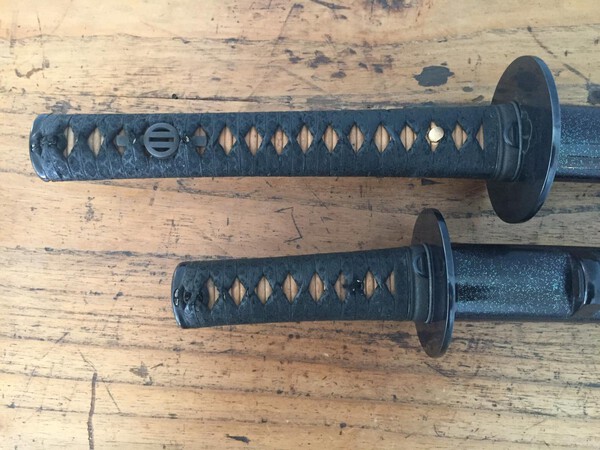

Katsujinken Posted March 1, 2017 Report Posted March 1, 2017 Hi folks, I'm curious if anyone here has ever seen any evidence of menuki being "reversed" (so they settle into the palms and not the fingers when the tsuka is gripped). It's a not uncommon choice among sword practitioners of certain styles today, and some claim it has a historical basis and improves grip and sensitivity. Nakamura Taizaburo writes that the standard placement today – what he calls the Edo style – came about after the need for combat subsided, but that prior to that the menuki were in opposite positions as described above. What say you, fine NMBers? Is there any historical evidence? 1 Quote
Derek Posted March 1, 2017 Report Posted March 1, 2017 Hi Michael, As I recall, Yagyu koshirae often exhibit reversed menuki placement. 2 Quote
Katsujinken Posted March 1, 2017 Author Report Posted March 1, 2017 Ah yes, Yagyu Ryu is one of the schools known for doing this, but I had no idea there were extant koshirae that we could refer to. Very cool. Quote
Derek Posted March 1, 2017 Report Posted March 1, 2017 http://www.japaneseswordbooksandtsuba.com/store/books/b997-owari-and-yagyu-koshirae 1 Quote
Ford Hallam Posted March 2, 2017 Report Posted March 2, 2017 The 1985 Tokyo National Museum exhibition, and catalogue 1987, "Uchigatana-goshirae" might be worth examining for evidence of what early Edo, and earlier, menuki placements might have been. From a quick browse though I'd suggest that the usual placement we see today, ie: under the finger tips, was most common even back then. Thare are a number of tsuka illustrated that look pretty ancient and to have seen campaign use. Where there are menuki present, not always the case, they are in the usual position. I think there is an unfortunate modern tendency to insist that everything on the sword has a functional reason for being there and while this may have some basis in terms of thing's origins true functionality is easily forgotten. The earliest hilt ornaments we might equate with menuki are 'tawara-byo'. There are the little gilt 'rice straw bales' that act as rivets to secure the same in place on kazari-tachi koshirae. In my opinion menuki evolved from these and I think attempts to try to imply a purely functional reason for them (menuki) being on the sword might miss the reality that they more likely had votive or talismanic meaning and/or were to an extent fashion/status signifiers. 5 Quote

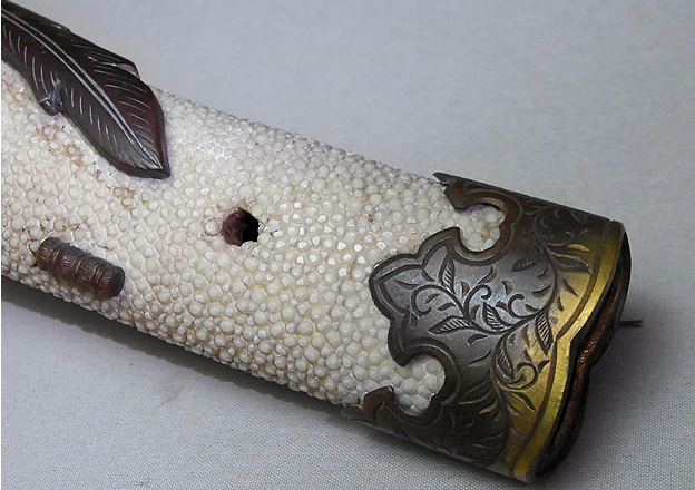

Ford Hallam Posted March 4, 2017 Report Posted March 4, 2017 Another little titbit to add to the story here. Something I happened on by accident this morning in the index of Henri Joly's Sword and Same. "Menuki: During the Fujiwara Period (presumably the Heian Period, 794–1185. ) rice bale shaped dummy rivets called sora menuki were placed on the haft (tsuka) , so that the lower edge of the nakago had to be notched to escape them." 1 Quote
John A Stuart Posted March 5, 2017 Report Posted March 5, 2017 You could call the menuki of the Uchigatana, Katana etc., Soramenuki, 'sora' meaning 'fake'. I think, Menuki actually refers more to the pierced hole itself, which we call Mekugiana now. The terminology has evolved. I wonder why the Nakago had to be notched? There was no actual rivet in the ornamental rice bale Menuki of the swords' mentioned by Joly was there? John Quote
Ford Hallam Posted March 5, 2017 Report Posted March 5, 2017 According to Markus Sesko's Encyclopedia of Japanese Swords sora menuki are imitation/fake menuki or ornamental menuki, whereas actual menuki were the peg and called makoto menuki, true menuki. Sora menuki, also called kasari menuki, came in to fashion from the Nambokucho period onwards. I think, Menuki actually refers more to the pierced hole itself, which we call Mekugiana now. To refer to Arai Hakuseki again (1657 - 1725) from his Honcho Gunkiko (Eighth Book). "menuki are things to put through the menuki hole (menuki ana) , to prevent the blade of the sword from coming out of the handle." Quote
John A Stuart Posted March 6, 2017 Report Posted March 6, 2017 A pic illustrating the rice bail soramenuki referenced earlier. John Quote

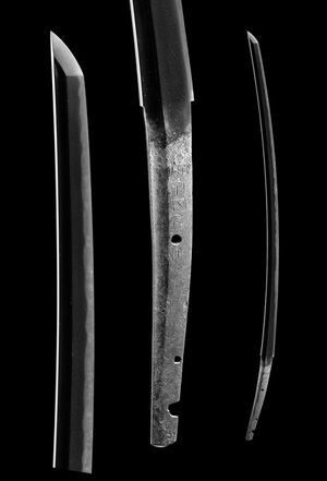

Lance Posted September 15, 2019 Report Posted September 15, 2019 Another little titbit to add to the story here. Something I happened on by accident this morning in the index of Henri Joly's Sword and Same. "Menuki: During the Fujiwara Period (presumably the Heian Period, 794–1185. ) rice bale shaped dummy rivets called sora menuki were placed on the haft (tsuka) , so that the lower edge of the nakago had to be notched to escape them." The sword Ō-Kanehira"seems to have one of these notches (and an additional little pin hole ana) I think the pic below was used for the cover Metropolitan Museum's Arts of the Samurai exhibit catalog. Regards, Lance 1 Quote

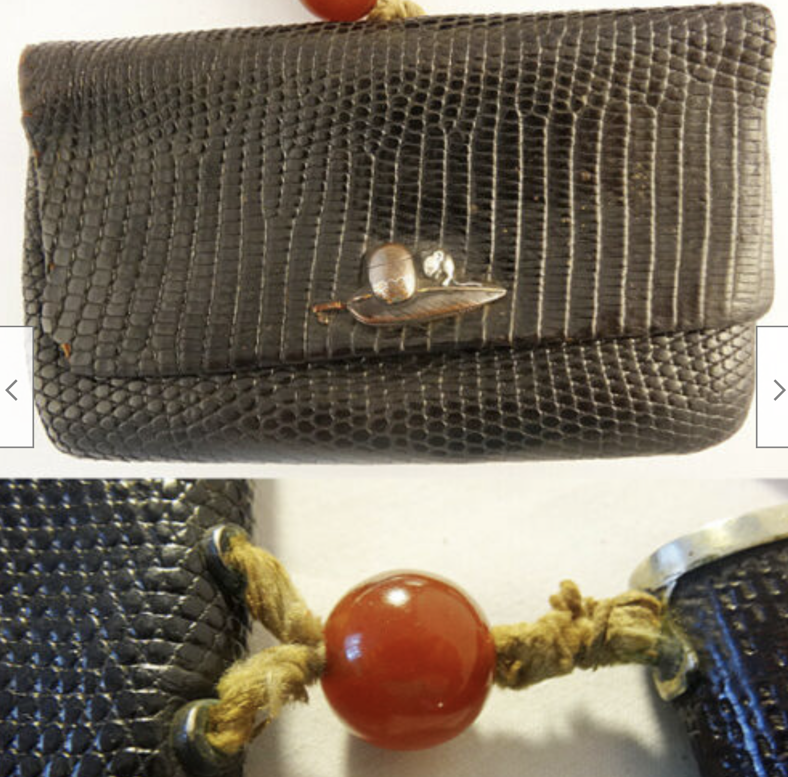

Tanto54 Posted February 25, 2021 Report Posted February 25, 2021 Hi David, As Michael said, these are tobacco pouch ornaments and the back plate is the "snap" that keeps the tobacco pouch cover closed. The ornament is attached to the back plate through the leather/fabric flap via the two thin wire posts, that's why the plate can be bigger than the ornament (because it is hidden behind the leather/fabric flap). These ornaments are sometimes converted menuki, but we would need to see the backs of yours to know for sure (but based on the looks of the fronts, most of yours were probably not ever menuki). 2 Quote
dir Posted February 26, 2021 Report Posted February 26, 2021 Ah - thank you! That certainly fits the bill I think. I collect tsuba and other sword fittings, and am unfamiliar with the inside of tobacco pouches etc. I'll remove the objects from the board and send a photo of the backs for interest. I think, though, my "menuki" would be rather small to be the decorative outer piece. I will give measurements. Thanks and regards David Quote

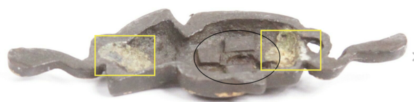

dir Posted February 26, 2021 Report Posted February 26, 2021 (edited) Here are the backs of the "menuki" and plates. The top left (3.8cm) is solid and has a small wire remnant at left, with one wire squarish pin in the plate (3.9cm). The one at top right (4cm) has one central post (?) with no wire attached, the plate (3.5cm) has one squarish pin. Bottom left (3.5cm) is solid and has two wires, the plate (3.5) also has a single thicker square pin. Bottom right (4cm) has two wires projecting - though I think it is actually one long wire that appears to run through a sort of tube; the plate (3.8cm) has a thicker pin which seems to have been slit at the end. Regards David Edited February 26, 2021 by dir Reached upload limit Quote
Tanto54 Posted February 26, 2021 Report Posted February 26, 2021 Dear David, You said that you think that your items are too small to be the decorative outer piece of a tobacco pouch. However, those decorative tobacco fittings come in many sizes, including those that are smaller than standard menuki (see photo below). The photo of the backside and the plates of your four items confirm 100% that these were kanagu (fittings or snaps) for tobacco or money pouches. Unfortunately, the photo of the backs that you provided is at an angle that does not let me tell you whether any of them are converted from menuki (I need to see a "straight on" photo of the backs). I've attached a photo of one of the things that I would look for below. The black oval shows were the single rectangular menuki pin was and the two yellow rectangles show where the later two kanagu (tobacco pouch ornament) pins were, so the one pictured below was originally a menuki and was later adapted to be a tobacco pouch pin (and then later someone removed the tobacco pouch pins). Quote
dir Posted February 26, 2021 Report Posted February 26, 2021 Your responses, George, prompted me to look at the back of all my other menuki to recall what was on the back. In virtually every case there is the small stem/root - presumably the kon as described by Sesko (and these were mainly bought from well-known auction houses in Germany and Austria with Japanese specialities and experts). In only a very few cases are there remnants on both sides of a wire fastening - and at least one of these has areas similar to what you show within the yellow box, and a couple still have the kon as well as the wire ends. Regarding the four I showed, I did try and upload a straight on image, but it seems I had reached my size limit! I thought it might be more important to see the wires. In fact only the one at top right has the kon. The other three do not appear to have had it removed. I'll try and upload the pic again. No - it won't let me do that. Let me try a screenshot - nope! Sorry! Just for info - these four were sent to a Dutch dealer friend of mine, who because he cannot travel to Japan at this time, gets consignments of all small things Japanese sent to him now and then by an antique dealer he knows over there and these were in the latest box (along with a tsuba). He thought I might be interested and indeed I was! I have learned something new and even though they might not be real menuki, they are still interesting objects for me! I appreciate your time and knowledge! Thanks and regards David Quote
Tanto54 Posted February 26, 2021 Report Posted February 26, 2021 Dear David, I am happy that I could help. Just to be clear, I think that kanagu are wonderful things and many are very highly regarded by collectors (at the same level as menuki). Just like menuki, there are good ones and bad ones. Many famous tosogu makers also made kanagu (like Natsuo). So in my opinion, nothing wrong with them being tobacco pouch fittings. Quote
