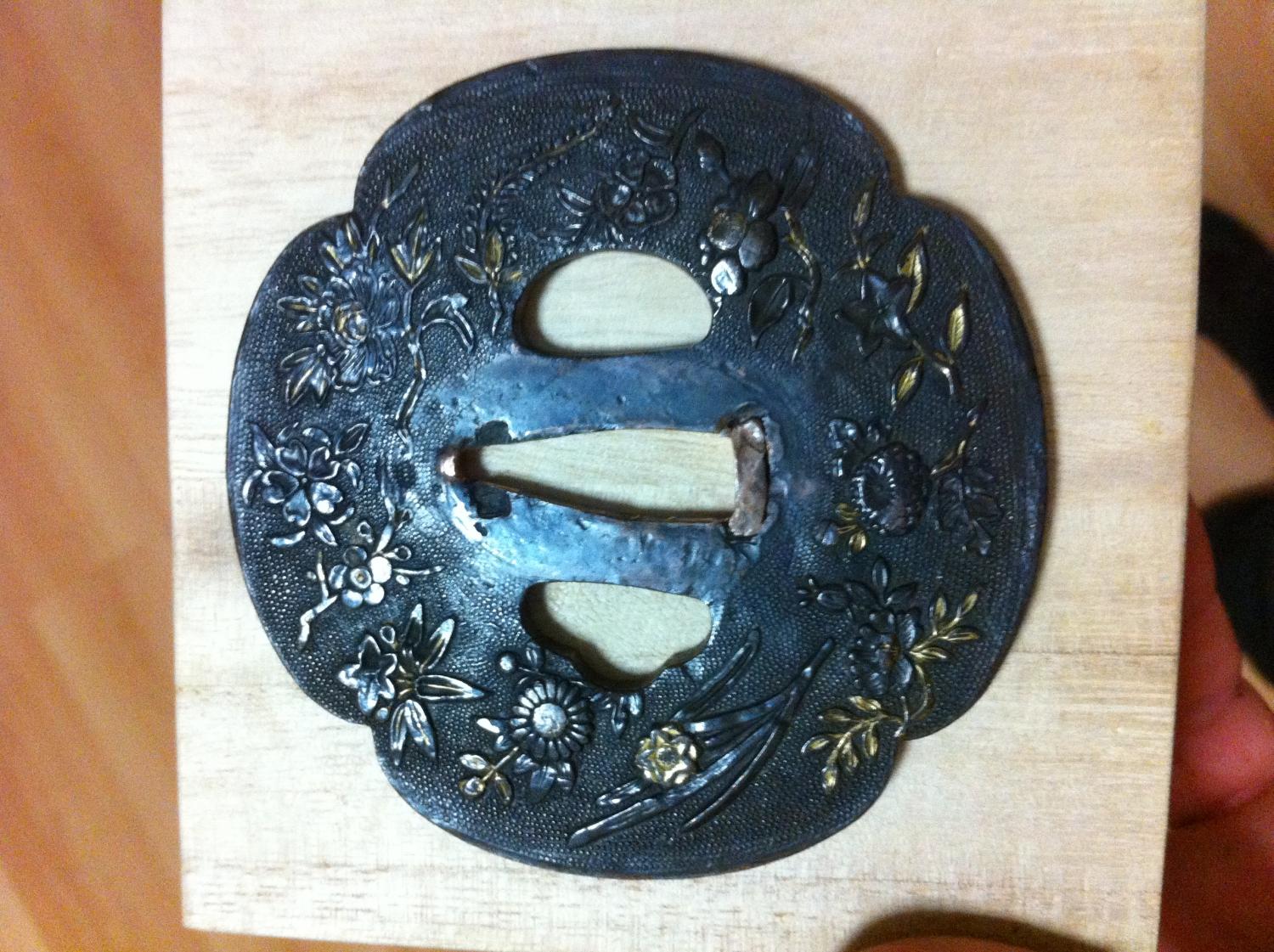

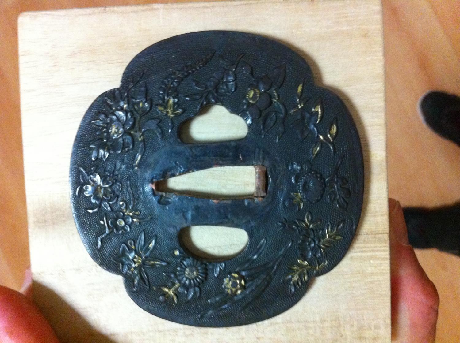

Hello Grev, i have a Tsuba that is around 2mm wider than the height. It is a sanmei, mokko shape floral design. Happy to put up a pic tomorrow if you need it. All the best.
Greg
here you go Grev, its not in the best condition but i enjoy looking at it under magnifying glass. Im not sure how common it is in regards to the width vs height but know ive seen it before. Interesting though.
cheers.
Greg

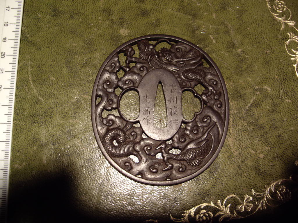

Haven't seen anything that is intentionally wider than tall but lots in nihonto to learn.
I think most are round(ish). I have one thats 84h 74w.
Both interesting Tsuba.
Peter I love the dragon Tsuba!
