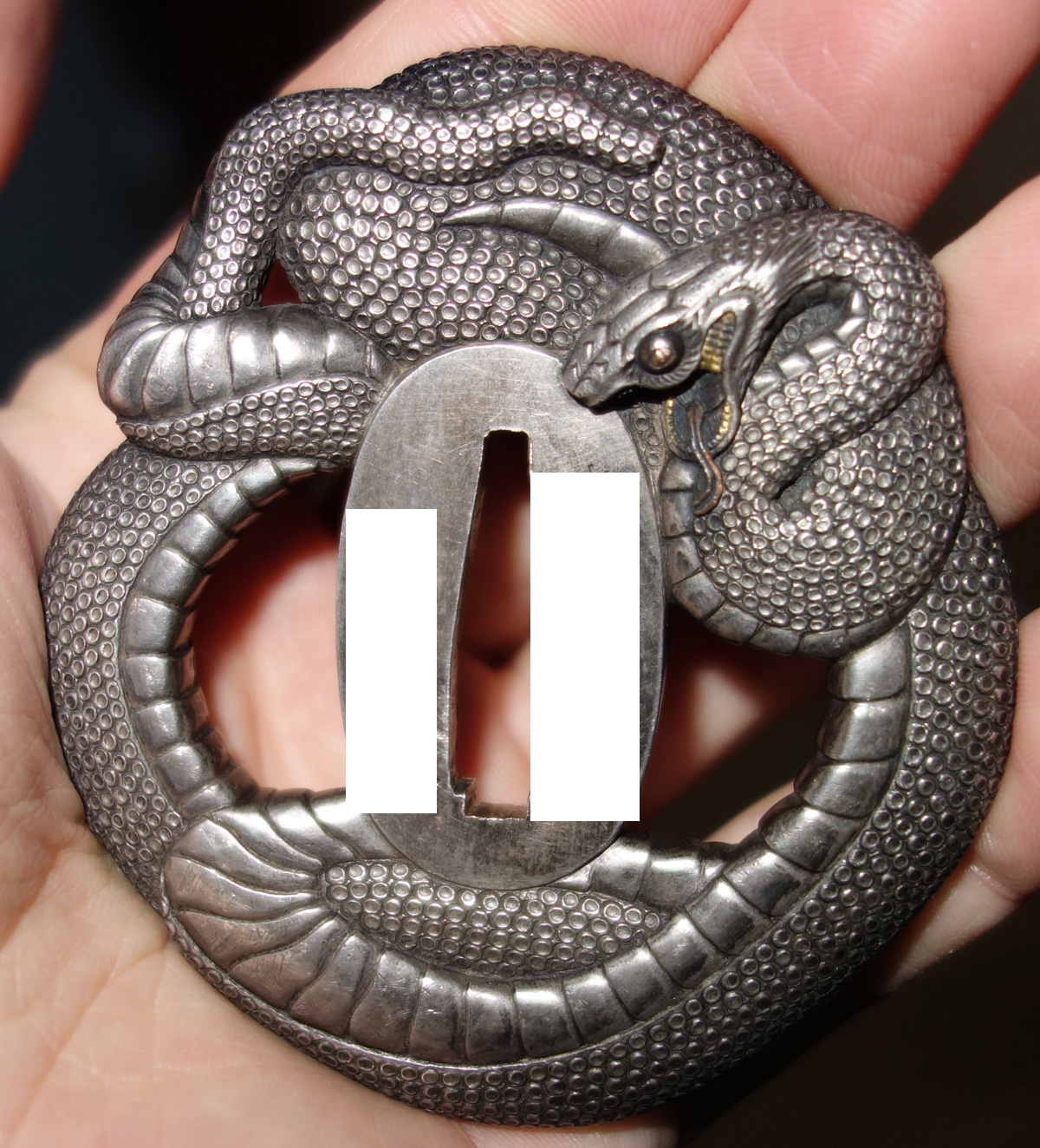

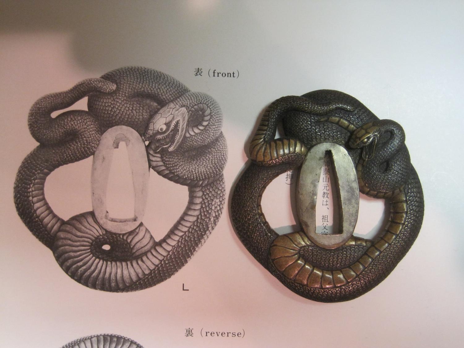

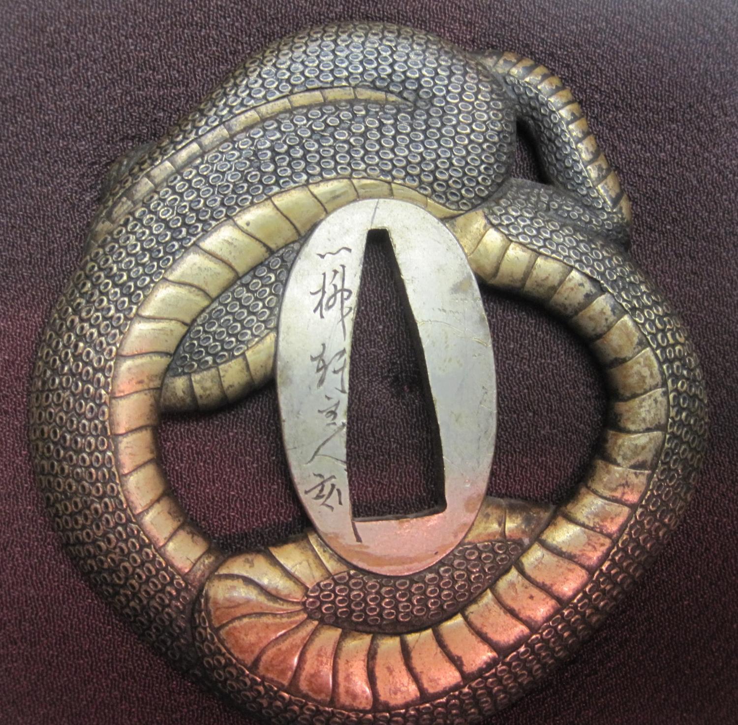

Ron STL Posted March 14, 2016 Report Posted March 14, 2016 Here is an interesting snake motif tsuba with a difficult to read (very difficult for me!) that I thought would be interesting to discuss. The tsuba, which appears to be brass, is beautifully carved and a rather exciting motif. The owner said he had noted: Ichi Ryu Ken shu jin Kizasmu and also, Hagiya Katsuhira Seiriken, in his records. He has been away from tosogu for many years, so I'm not sure how accurate any of this is. Comparing this tsuba with a similar tsuba in Dr. T's Toso Soran (which appears to be the work of the Master tsubako), the book example looks more "flowing" in form that the one in hand. While this tsuba appeals to me, it is of the type of kinko I've never had much experience in. Can anyone identify the maker and/or care to comment on it, good or bad? Ron STL Quote
Rivkin Posted March 14, 2016 Report Posted March 14, 2016 A somewhat common XIXth century design, used by masters from different schools (Mito, Nara etc. etc.). The quality here is above average. Quote
ggil Posted March 14, 2016 Report Posted March 14, 2016 Wow! Now that is excellent looking to my eyes (drool). The scales are not done as well as could be. I really like this motif though. I really Love the Tsuba and would jump at it if it was around $500. Maybe worth more since it is signed though. Thanks for posting this little gem. -Grant P.S. I'm a novice in the nihonto collecting game so this is pure opinion at best, or total garbage at worst Quote

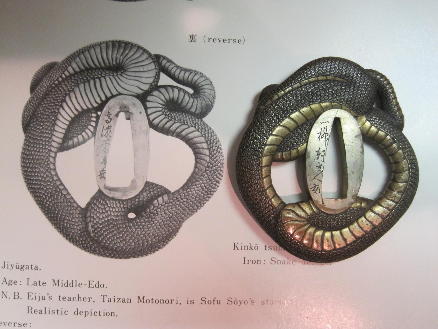

Ian Posted March 14, 2016 Report Posted March 14, 2016 Here is a couple from the Stibbert collection. One similar to yours and the one from the book? I hope it helps Best wishes Ian Quote

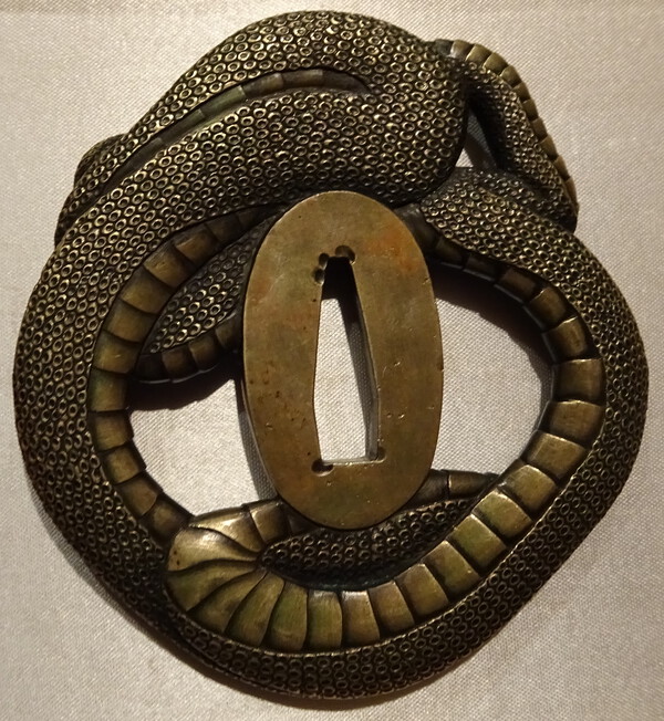

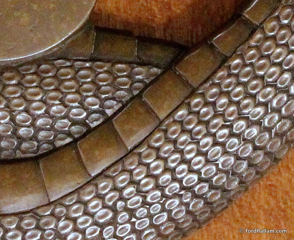

Ford Hallam Posted March 14, 2016 Report Posted March 14, 2016 These are almost always cast brass pieces and frequently seem to have been originally silver plated. They do tend to be fairly well finished. The scales are not actually carved but in fact formed by the use of two punches. One creates the outer shape of the individual scale and another is used to stamp the dimple in the centre of the scale. Of the two examples Ian has posted above the one on the right reveals a very clear and bold crystalline structure that is indicative of 'as cast' brass. This means the metal has not been forged in any way as forging breaks down that large structure. They appear to me to be very late 19th century phenomena with many examples being almost identical, despite the variety of signatures they bear, this suggests to me a single place of manufacture. My personal feeling is these may have been made once foreign visitors were actively buying 'samurai treasures' because I don't think serious Edo period tsuba buyers would have accepted this obvious 'mass production' approach in terms of the processes employed. Here's another which exhibits that 'as cast' structure on the seppa-dai. The snake motif, in this bold style was, of course, used by a number of legitimate tsuba-ko in the Edo period but these late cast versions rarely appear to have been mounted and the nakago-ano are often very badly shaped, suggesting to me, again, that they were made for a clientèle unfamiliar with 'real' tsuba. 4 Quote
Ron STL Posted March 15, 2016 Author Report Posted March 15, 2016 All very interesting and educational comments, much appreciated. Ford's pointing out the "casting" structures and also how the scales were "punched" is so helpful to recognize. I remember seeing this type of kinko work showing up at sword shows back in the early 1970, often being sold by the Steinmetz brothers. Wonder what ever became of them? While an interesting motif, I'll stick with ko-kinko and good iron for the most part. I'm always amazed to learn how some this work is actually created, such as when Ford explained how radiating lines are cut on the surface of a tsuba. Thanks! Ron STL Quote

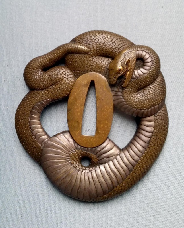

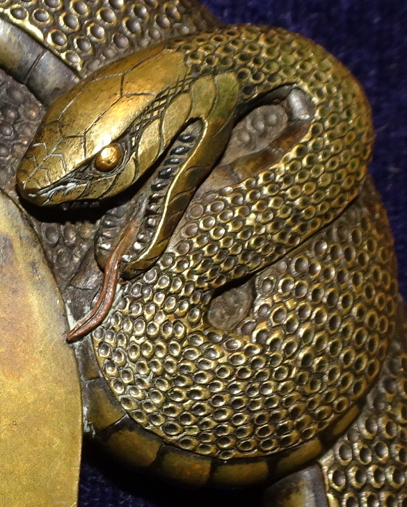

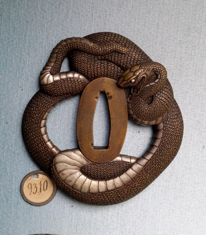

FletchSan Posted December 4, 2018 Report Posted December 4, 2018 Hi All, A recent acquisition and another member of the snake tsuba family! Interesting that the consensus is that these were cast and produced possibly for westerners late edo - though in my initial research I can't find two exactly the same. The snake heads in particular are all different and the detail in hand is stunning. Similar quality ones are in collections at the V&A in London and MET in New York. cheers, Ben Quote

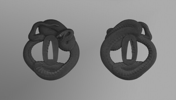

FletchSan Posted December 5, 2018 Report Posted December 5, 2018 @Uwe - yours is quite similar to mine. I’m going to start documenting all of the variations Is yours actually that dark colour or is that a B&W scan / photo? Quote
CSM101 Posted December 5, 2018 Report Posted December 5, 2018 The color is a little bit darker as in the first photo from Ian #4. But the color version is for a catalogue. But I still wanted to share so you only get the b/w version. Uwe G. Quote
