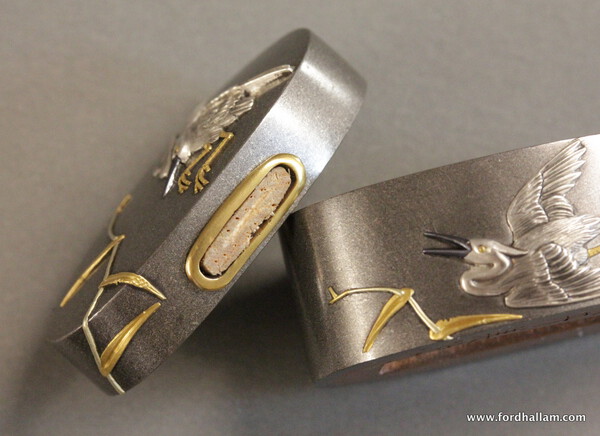

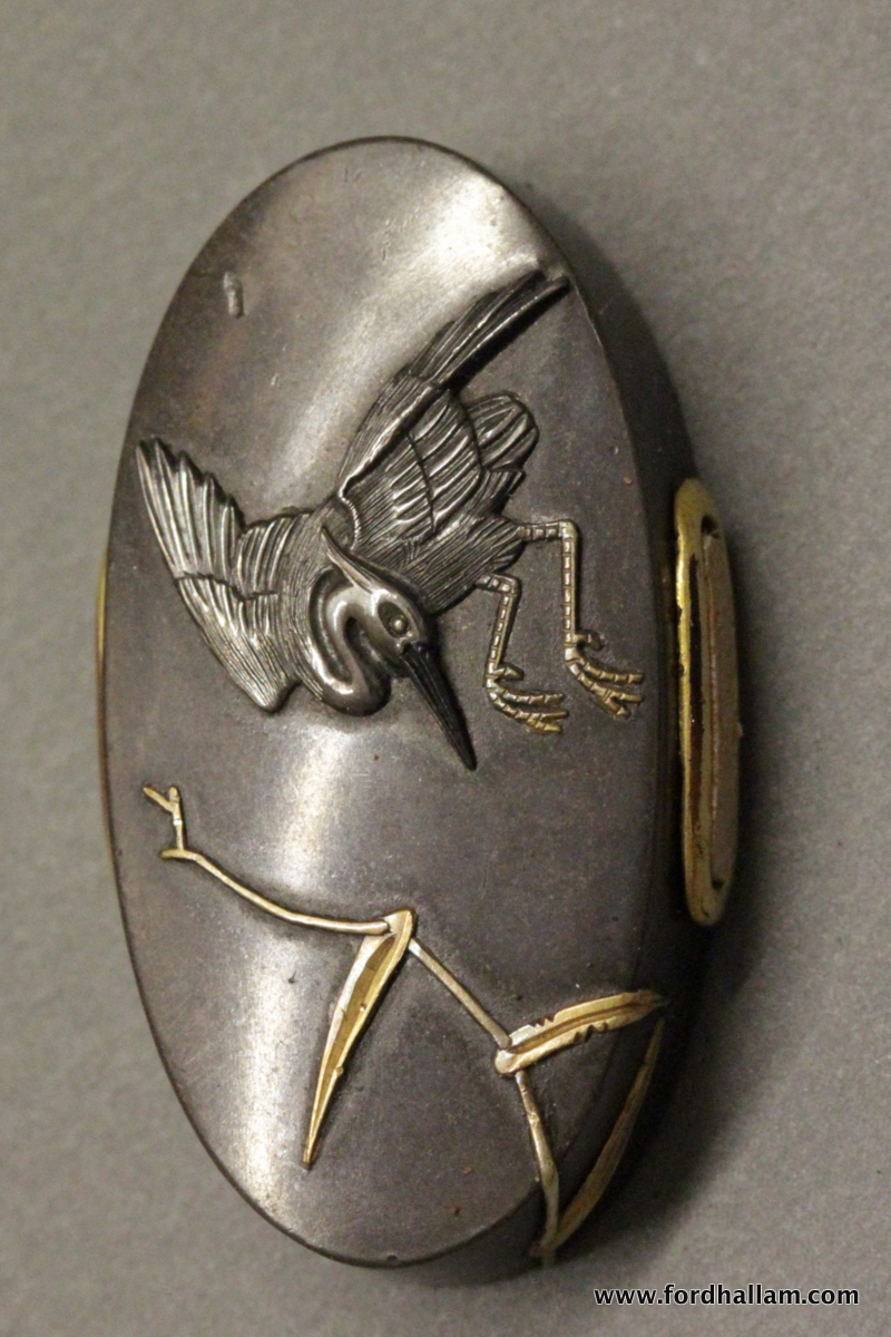

Ford Hallam Posted September 1, 2015 Report Posted September 1, 2015 This is a set I've just restored for one of our members here, Mr Max Bini. He has graciously allowed me to share these before and after images of his pieces so that I can illustrate some aspects of proper restoration and features of shibuichi. Double click on the images to see bigger versions. This is the kashira. The original patina has darked down considerably over time due to sulphides in the air combining with the silver component of the alloy. Most Edo period pieces in shibuichi have suffered the same fate. And the fuchi. Notice how the patina is lighter around the actual inlay. This, as well as the narrow strip protected by the shitodome in the kashira, provides a clue as to the original patina colour. And this is the kashira after I'd polished out the marks at top right, refinished the surface and brought the patina back. The silver has been treated with a gold salt solution and will, over the following months, develop a more mellow pewter-like patina. Artificailly aging the silver using a more rapid process will result in an ugly black finish in a few months which would defeat the whole object of sympathetic restoration. The characteristic 'nashiji' texture that is the defining feature of good shibuichi is now clearly visible. That soft, almost velvety, sheen is also a result of the silver:copper structure of the alloy and the way it patinates. A close up of the 'nashiji' ground, looking a bit like grey felt. The shitodome were a bit worn out too so they got a spruce up also. 9 Quote

ROKUJURO Posted September 1, 2015 Report Posted September 1, 2015 Amazing work!I am so accustomed to see SHIBUICHI in that dark grey that the restored set seems to look almost too new in a way! But I am thankful to learn how these items looked actually when they were made. I include samples of that usual dark grey. Quote
Ford Hallam Posted September 1, 2015 Author Report Posted September 1, 2015 Jean, I think that in the 60's, at least in the UK, blade collectors got used to collecting swords that were in pretty poor polish too. But things improve,thankfully The same with old master paintings. we now accept that they sometimes need to be cleaned. Having said that not all patina should be redone, imo. Shibuichi is merely a very fragile one that doesn't age well. Shinchu patina is also quite easily lost resulting in a brassy tarnished surface from too much handling. 3 Quote
Heringsdorf Posted September 1, 2015 Report Posted September 1, 2015 You can tell that this is how Shibuichi is supposed to look. So much more character after the restoration. I think, once the silver darkens a little more over the next year, it will look even more stunning. 2 Quote
Justin Posted September 1, 2015 Report Posted September 1, 2015 Great work Ford. Makes a big difference. The ground was flat and dull and now it looks like a nice marble finish. 'Grey felt' is a good way of describing it. Thanks for posting. 1 Quote
Ford Hallam Posted September 2, 2015 Author Report Posted September 2, 2015 Thanks Gents, glad you appreciated seeing them. Jussi, it just occured to me as, as I was doing the job, that what I take for granted in my everyday work may be unknown to many collectors of tosogu so this was a convenient opportunity to share a glimpse of what is too often hidden. :-) Restoration of metal fittings is a touchy subject sometimes but I think there are times when intervention is warranted. There is, of course, the appreciation of the appearance of age on the pieces we admire but this is not always all that relevant on every type of work. I've learned over the course of the past year, while researching my book, quite a bit about day to day life of Samurai on duty in the capital. Numerous personal diaries exist that document day to day activities and expenses. Of note are those entries detailing sword and sword accoutement care. Saya were re-lacquered, hilts re-wrapped, sometimes twice a year, and the finish on tsuba and other fittings had to be maintained. Iron tsuba in daily use needed to be periodically retouched. Kinko work is not very robust so that too needed regular attention. Sincet hese things no longer have a place in daily life they have, ironically, suffered from a lack of maintainace and what we see today is a far cry from how these pieces were understood when they were in use. While we may appreciate a worn and tarnished piece of metalwork it's likely 'back in the day' they'd merely be seen as dirty and the owner as a bit of a careless scruff. Another thought that just occured to me.... As we've now seen this dark appearance of shibuichi really wasn't how it was seen in the Edo period at all and in fact the author of the Soken Kishō (1781) tells us that of the varieties of shibuichi it was those with more silver, the paler ones, that were most admired. 1 Quote
