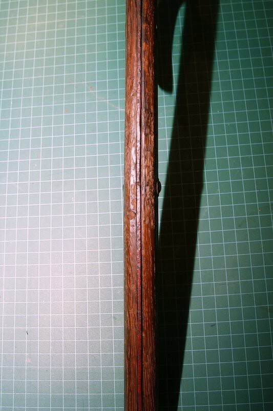

GregN Posted April 11, 2014 Report Posted April 11, 2014 Hi all, I've always thought the for some reason the Japanese didn't use axes as weapons, preferring bows, pole arms, swords and eventually firearms. With this thought in my mind I bought this axe years ago, thinking it Chinese rather than Japanese. I mentioned my axe to a new friend from the Vancouver Japanese Sword Club and sent him these images. He immediately answered that my axe is actually Japanese! The signature says: "Right side number 134". The blade is very well made, it make a nice "ping" sound when struck. The handle is red painted metal, sandwiched with oak slabs, then rivited together. The axe head is offset to maximise cutting ability. It would make a formidable weapon, or tool. With this information in mind, what is the history of axes as weapons in a Japanese context? Is my axe a weapon or a tool? Regards, Greg Quote

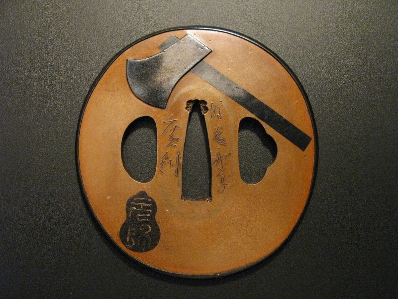

Kurikata Posted April 11, 2014 Report Posted April 11, 2014 Interesting and nice item In woodblock prints the Japanese axe (used as weapon) looks more like this: http://www.michitrading.com/images/396_ ... an_axe.jpg or this: http://cdn2.brooklynmuseum.org/images/o ... LS_PS3.jpg which corresponds to this instrument: http://www.hidatool.com/image/cache/dat ... 50x650.jpg In fact another example of a Japanese axe design on a Tsuba..... Looks similar to Marius' woodblock prints... Quote
estcrh Posted April 12, 2014 Report Posted April 12, 2014 The general shape is known from India and Persia. This axe does not seem to be very old, so I ask if it could be a firefighter's tool from China or perhaps Japan? Agree....it looks like a shamshir axe Persian origin but no idea how the kanji got there Actually a "shamshir" is a sword, a "tabar" would be the name you are looking for. This is not a Japanese style of axe no matter what is written on the blade, having a metal plate run down the handle is an Indo-Persian style, the head is an Ottoman/Syrian/Mamluk form. Hereis a link with many types of Indo-Persian axe. http://www.pinterest.com/samuraiantique ... r-and-axe/ Here ia some typical Japanese axe (ono) shapes Quote

GregN Posted April 14, 2014 Author Report Posted April 14, 2014 Hi all, thanks for the comments so far. I often wonder what an artifact would say if it could talk, how did a Persian axe find its way to Japan? I note on Bruno's tsuba, the offset angle of the blade to the handle is well represented while the wood-block prints tend to show the angle at 45*. How accurate are the depictions of weapons in such prints? Greg Quote

estcrh Posted April 18, 2014 Report Posted April 18, 2014 Somewhat similar to the Swedish broad axe used for squaring timbers. They are commonly offset to protect the users knuckles.I vote for a tool. If you look at the handle of thie axe being discussed you will see a metal plate inserted between the two halves of the handle, this is done in Indo-Persian axes, I have only seen this in axes meant for battle, there is no use for this in a tool and I have never seen this in a Japanese axe. Below is a picture of a 18th to 19th century Indian tabar, you can see the same plate inserted in the handle. Quote
