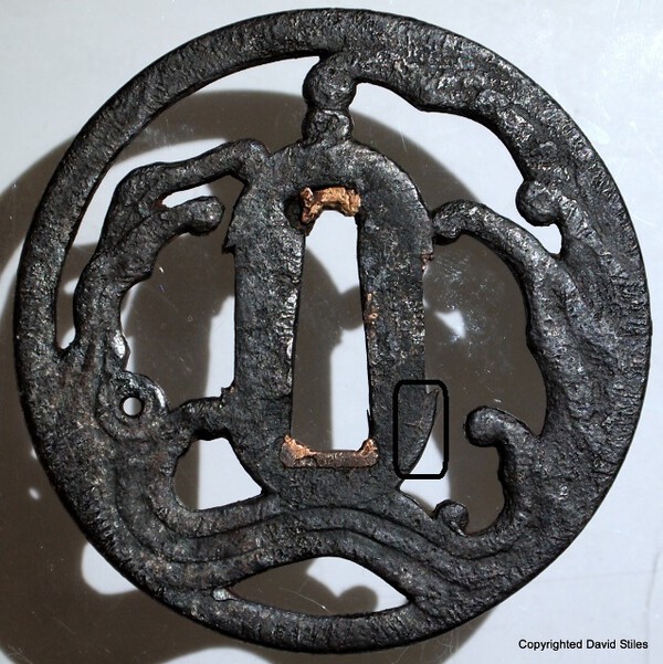

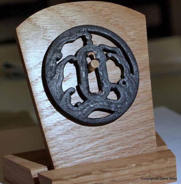

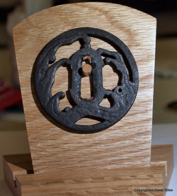

Hi Everyone,
Here are some photos I was able to take today of a classic Yagyu tsuba in my collection that I will be soon adding it to my website. I consider my work done on this tsuba in terms of removing the vintage lacquer/paint. I am suspecting this was added on the tsuba likely around World War 2. The dynamic boldness of the openwork design of a standing wave along with the texture of the course sandy iron I find very appealing. The massiveness of this tsuba is remarkable given the small size of 7.4 cm. I don't think the ura side will ever look as good as the omote side given what was done to it but time will tell and I am planning to keep this tsuba for a very long time. I am planning to submit this tsuba some time next year to the NBTHK for Hozon level shinsa.

It looks like it once had inserts in the two ana.
Hi Barry H.,
You might have seen this tsuba at the Tampa show this year because the previous owner if I remember correctly had it at the show. I have noticed that to with the inserts. From examining the guard some more in hand I noticed that the following area along the seppa-dai is a copper insert that has been patinated and colored to match the near by iron of the seppa-dai. I have it highlighted in a black box in the photo below. It is little more noticeable on the ura side.

David,
I had also marked this area (among others) in the previous thread when you presented this TSUBA. How does this copper strip hold in place if not by soldering?

Hi Jean C.,
No I was wrong I tested with a magnate and it is iron. I used another part of the guard as a positive control and the copper sekigane as a negative control with in magnate experiment. I am now thinking copper was scraped across it and left a little bit of copper residue which made me think the underlying metal was another copper insert.
