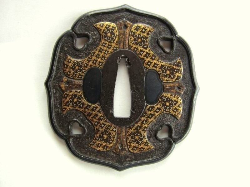

Bernard Posted November 10, 2013 Report Posted November 10, 2013 Hello everybody. I read that Tachi tsubas must be photographed that way (nagako-ana upside down). Can somebody explain me why ? On this one, the four "crosses" do not look as well preserved as the rest of the decoration. Any guess why ? Regards. Bernard D NB : the four "arrows" Quote
Geraint Posted November 10, 2013 Report Posted November 10, 2013 Hi Bernard. To answer you first question: because that is the way the tsuba would be when mounted on a tachi which were worn cutting edge down. Your second question is more difficult from these pictures, my guess would be that two different techniques have been used, hon zogan or true inlay for most of it and perhaps nunome zogan for the crosses as you describe them. If under a magnifying glass you can see a cross hatched surface where the gold appears worn then that would indicate nunome zogan. As it is much more on the surface then it is more likely to wear over time. Hope this helps. Quote
Gunome Posted November 10, 2013 Report Posted November 10, 2013 Hello Bernard, Nice tsuba. the mimi seem to be circled in shakudo. What puzzle me is that this tsuba has hitsu ana, and tachi normally don't have it. So, not sure it was done for a "real" tachi koshirae, but maybe more a hantachi style koshirae ?! (just an idea, not an opinion) You have a very nice collection Sébastien Quote
sanjuro Posted November 10, 2013 Report Posted November 10, 2013 this tsuba has hitsu ana, and tachi normally don't have it.So, not sure it was done for a "real" tachi koshirae, but maybe more a hantachi style koshirae ?! I tend to agree. A tsuba originally made for mounting on a tachi never has hitsu ana since kogai and kozuka were not mounted on tachi Koshirae. Having said that, some tachi tsuba were later pierced with hitsu ana in order to mount them on katana. This tsuba however, was obviously made with hitsu ana so therefore it cannot be an original tachi tsuba. The style is called aoi gata and was used on katana as a 'formal' style and referred to as han tachi or han dachi. Nice tsuba! Quote
Pete Klein Posted November 10, 2013 Report Posted November 10, 2013 My gut hunch is that this is not a tachi tsuba but one made in the style thereof. If you look at the rotated picture below you can see the hitsuana are original as the gold design follows the hitsuana. If it was a converted tachi tsuba the design would be cut into without the delineation. PS: Keith and I were in Vulcan mind meld. (lol) Quote
Stefan Posted November 10, 2013 Report Posted November 10, 2013 Nice tsuba. Nunome all over. slightly worn at the higher Points. (cross ) It is in my point of view an handachi tsuba in kaga-nunome style. It looks a litte bit like kenjo tsuba. Quote
Bernard Posted November 10, 2013 Author Report Posted November 10, 2013 Thank you very much, gentlemen, for all these interesting and informative comments ( Geraint, you were right for the cross hatched surface). Greetings from Switzerland. Bernard D Quote

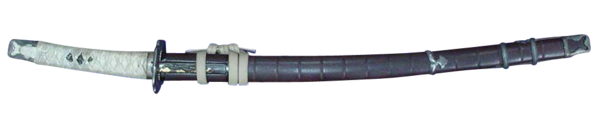

docliss Posted November 11, 2013 Report Posted November 11, 2013 Am I corrct in thinking that handachi koshirae do not properly include kozuka and kogai? John L. Quote
John A Stuart Posted November 11, 2013 Report Posted November 11, 2013 I have a good handachi koshirae that includes them. John Quote
Guido Posted November 11, 2013 Report Posted November 11, 2013 Although not the norm, both Kôgai and Kozuka were occasionally mounted on Handachi: Quote
sanjuro Posted November 13, 2013 Report Posted November 13, 2013 Am I corrct in thinking that handachi koshirae do not properly include kozuka and kogai? John. For what its worth, I have owned good examples of handachi koshirae that both included kogai and/or kozuka, and also those that didnt. It would seem to depend on the age of the koshirae as to whether the implements formed part of the koshirae, since from my own experience the older koshirae tended not to have them, whereas the more recent koshirae did include them. I am however making an observation here based on some less than a dozen examples over time, so it is not a large sample group. Illustrated examples in various works however, do tend to support my observation. Perhaps Guido can add something here, since his observations will be based on a wider scholarship than my own. Quote
