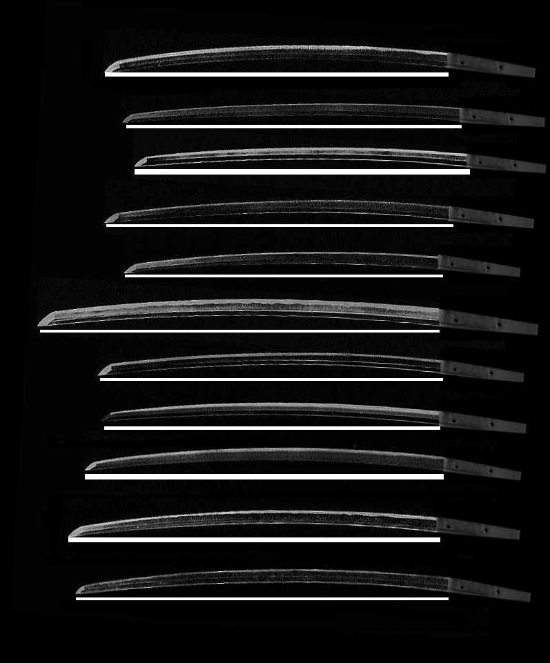

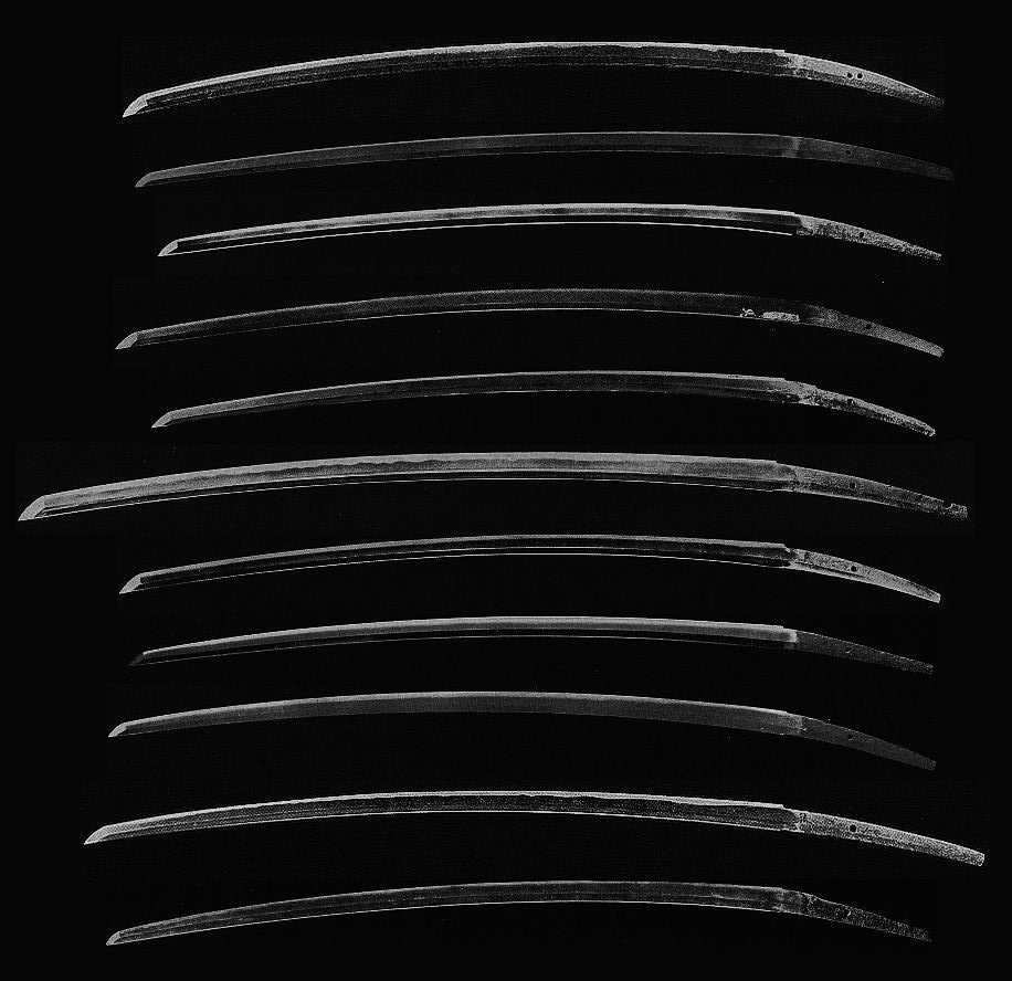

Jacques D. Posted October 19, 2013 Report Posted October 19, 2013 Hi, All these sword are late Heian and early Kamakura : Source Markus'sblog
cabowen Posted October 19, 2013 Report Posted October 19, 2013 And the majority of them have koshi-zori... Ugh, never mind. I know better than to try to have a reasoned discourse with Jacques.....
Lance Posted October 19, 2013 Report Posted October 19, 2013 I hope Jacques doesn't mind me taking his picture and doing a virtual o-suriage and imaginary nakago for comparison in the images below, to illustrate how the loss of koshi-zori by greatly shortening produces what seems in general tori-zori, even with the varying amount of sori in the different blades. I tried matching the natural curvature with the added nagago, and I know it's not perfect, but I didn't alter anything in the shape of the blades themselves, just rotated a few to make it easier to match up a straight line for each one. (even if it's only done in pictures it still looks like sacrilege! ) Regards, Lance
