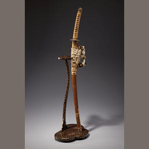

Not sure about shira saya, but for a mounted tachi I always thought one of the main reasons for being displayed point up-tsuka down is a a balance/safety issue as the tsuka nakago section is heavier, making it more stable and also to protect the point. If the blade was displayed point down it increases the chance can it slide down and damage it if the mekugi or tsuka was loose?
sword pictured below from Bonhams looks like it's about to fall over
http://www.bonhams.com/auctions/17513/lot/3163/

Attached is a photo of what the tachi kake and tachi looked like. Looks better this way than the other, but still a little absurd towering at 4ft. You guys gave me enough information to think I was pushing it to try it.
The katana kake I have is that mid edo one. At 260 years, I hesitate to drag it to the sword show.
~But it may be better for the tachi.
The tachi kake will probably hold an Owari koshirae. I hate to separate it from its blade on the katana kake, but it seems wiser on a variety of fronts. As Jean pointed out, the neck is narrower. It held the shirasaya very snug, and is more at ease with a smaller katana koshirae in it.
