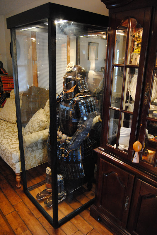

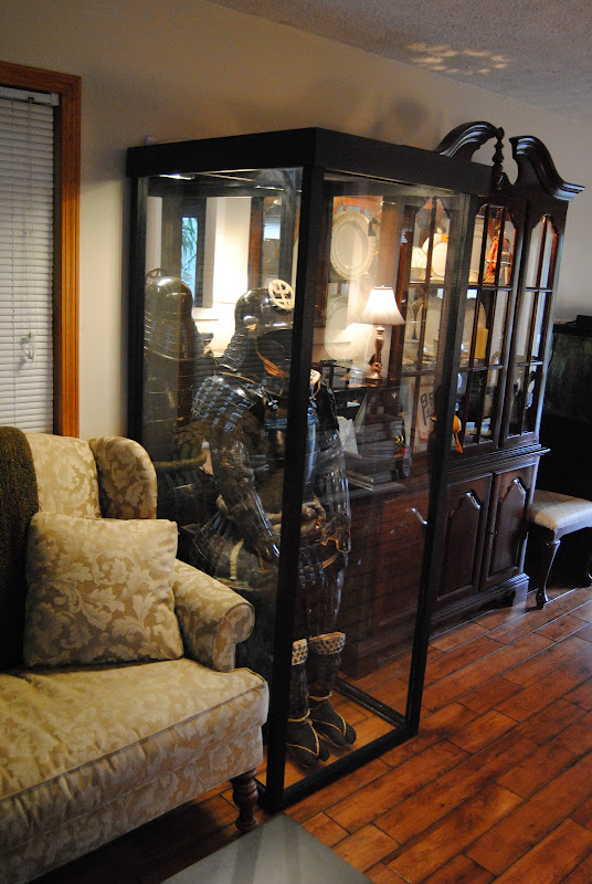

Justin Grant Posted January 27, 2013 Report Posted January 27, 2013 I made this case for my armor. It is oak wood with black stain with 1/8" tempered glass on the front, left and right sides and bottom. The back is a 1/4" mirror and the top is a sealed oak lid with LED lights and a hygrometer to measure and record humidity. It is not "air tight" but restricts air movement slowing the temperature changes within the room to take hours to equal-liberalize, thus preventing the urushi from cracking. It also prohibits any pests from entering easily, and LED light does not attract flying insects. I am sure there are better, and if you want to know how I did this, I can email you the details. Justin Quote

Justin Grant Posted January 27, 2013 Report Posted January 27, 2013 Hi Dave, You are correct, and I used UV filtered glass, filtering 99% of UV light, and I have since moved it to be nowhere near a window or direct light. That room is the "to look at room" and we have light blocking drapes over the windows now. I had to make a choice, hide it away or employ a high degree of safe guards so I can keep it out and enjoy it. It is a personal call most of us have to make that care for these wonderful items for the next generation. UV Glass, LED, and thick drapes will help, I also keep that room at 68 degrees 24 hours a day, 365 days a year and I have a room humidifier that keeps it at 45%. Best I can offer. Quote
md02geist Posted January 27, 2013 Report Posted January 27, 2013 I made this case for my armor. It is oak wood with black stain with 1/8" tempered glass on the front, left and right sides and bottom. The back is a 1/4" mirror and the top is a sealed oak lid with LED lights and a hygrometer to measure and record humidity. It is not "air tight" but restricts air movement slowing the temperature changes within the room to take hours to equal-liberalize, thus preventing the urushi from cracking. It also prohibits any pests from entering easily, and LED light does not attract flying insects. I am sure there are better, and if you want to know how I did this, I can email you the details. Justin What a simple and beautiful way to display your armor. I very like what you have done. Do you have a hidden latch/hinge somewhere to be able to open it if you so desire? I do not have a suit of armor but one day I intend to get one, and if/when I do I will likely do something very much like this. Quote
Justin Grant Posted January 27, 2013 Report Posted January 27, 2013 Thank you. Yes, the entire back comes off with 4 draw tight buckles. The glass on the sides and bottom extend 3/8" and slide into groves in the back panel. The buckles draw it in and tight. The glass is set in groves on each piece of wood. I cut a single grove the entire length with a table saw that is .250" wide and .375" deep for the .180" glass (room for wood to flex without cracking the glass). I then put a small amount of silicone in the grove and placed the fixed glass pieces into the wood. The wood pieces are joined with wood pegs that are glued. Very solid, but if I did it again, I would find a way to hinge the back, but I manage Quote
md02geist Posted January 27, 2013 Report Posted January 27, 2013 It's awesome, great work on it and nice work leaving a little extra space for the glass. Quote

Justin Grant Posted January 28, 2013 Report Posted January 28, 2013 FWIW, your LED lights might be a problem too - check this out: http://www.huffingtonpost.com/2013/01/1 ... 72742.html Best, rkg (Richard George) Richard, LED's do not produce UV. I also use LED light on my 150 gallon reef tank and keep many SPS and LPS corals that are sensitive to UV and they are growing like weeks. When under Metal Halides, they need UV filters over the bulbs from killing the Acro's. Let me be honest, I don't have the light on but to show it off in detail once in a while. The room is rather dark, even in the middle of summer. The temp and humidity stay at or around 68 deg 45-50%. The armor is cleaned every 90 days with a concoction recommended by Ian. The glass is rated as 99% UV filtering, and I have to trust that it works, and the room is fairly dark 24x7. All of the lamps in the room use LED bulbs. As I said, I could stash it away in the cellar and just know it is there, or I can employ a high degree of safeguards and enjoy it. To put the level of light in the room into perspective, you would not be able to read a book in the room, even with the lamps on. The light used during the pictures you see was just after completion of the case a year ago. Ian provided me with plenty of cautionary tails and I put as many safeguards in place as I could taking my approach of displaying it. If I took a picture of the case now, it would be hard to make out due to the low levels of light. Again, it is simply a room people pass by and don't use, so I use it for my armor. If I feel like looking at it, I can sit in a chair and stair at it for a new moments and then move on. Each person has to make up his or her own mind on how to display or store the armor they own. Quote
