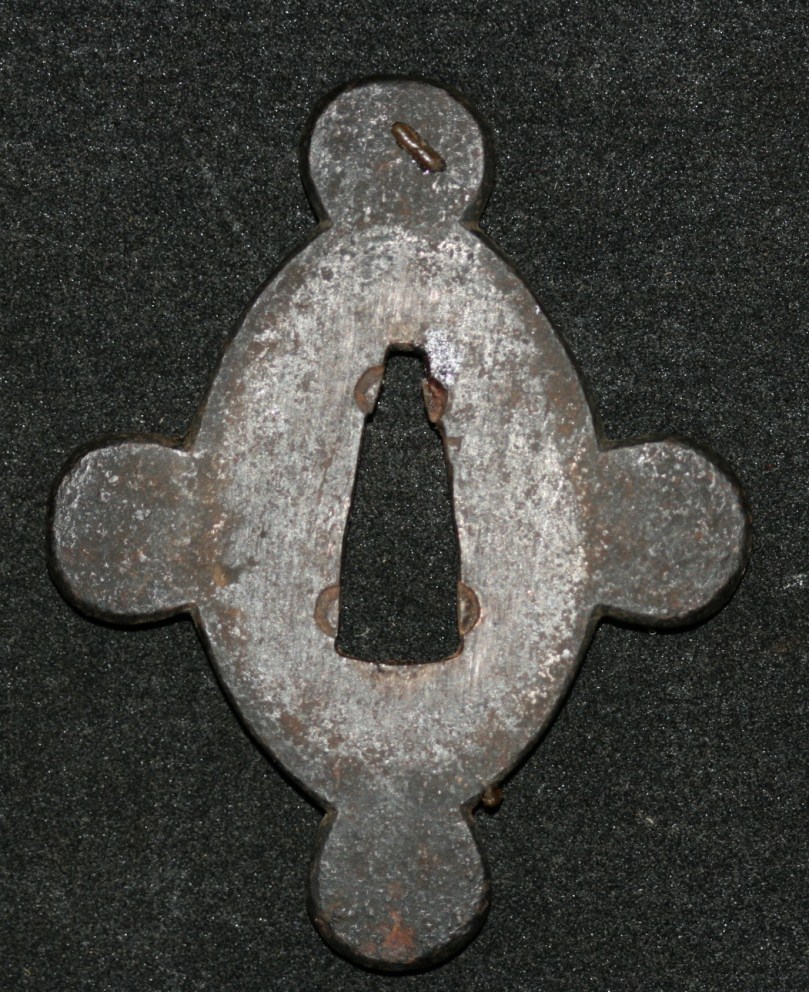

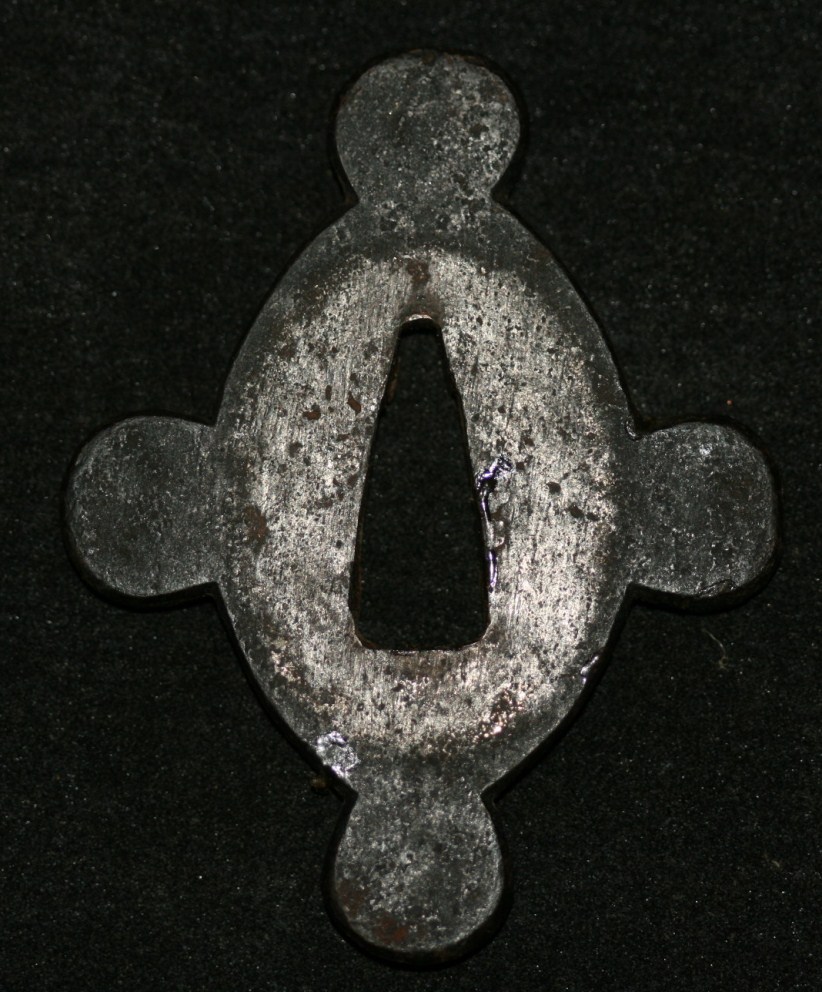

In support of your thick wakizashi tsuba statement I have included here pics of 2 of my naginata tsuba. They seem to support your theory.
Other side.

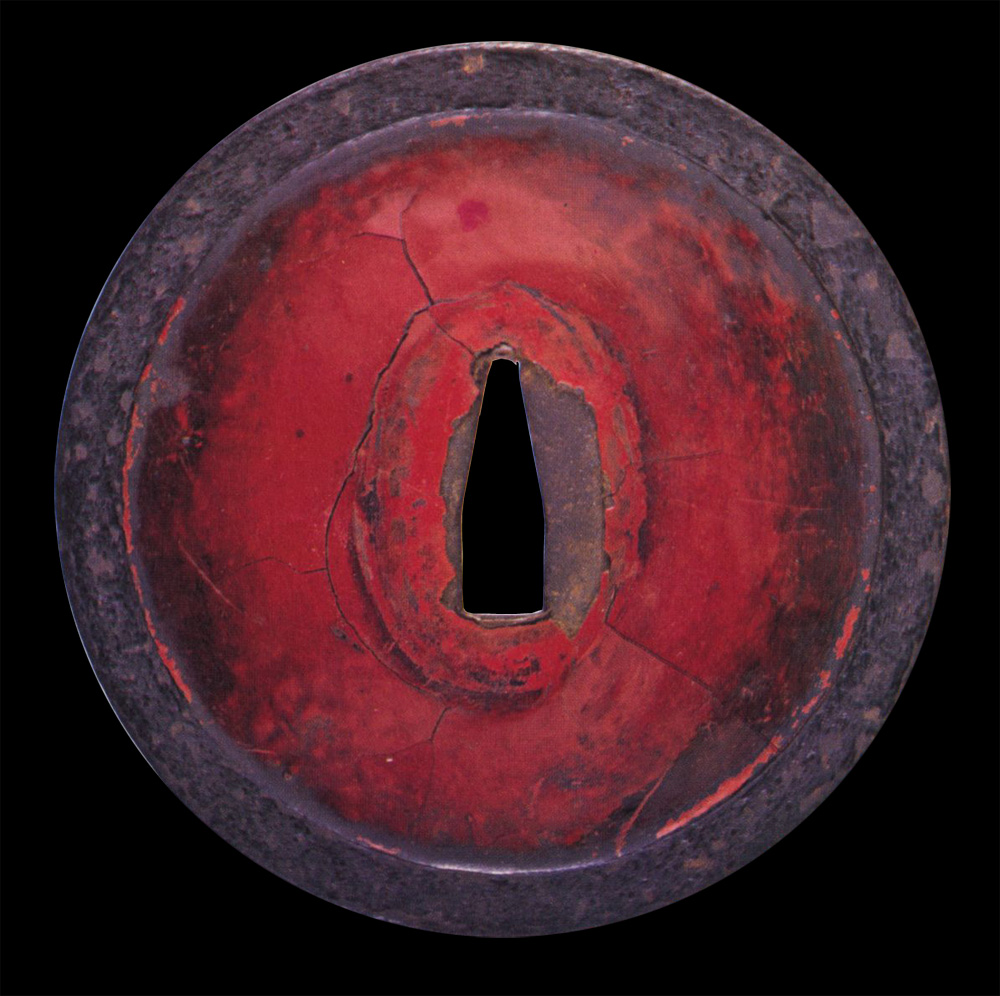

This iron Tsuba is associated with a Momoyama Naginata signed by Shimada Hirosuke. It was originally covered with black urushi which an enterprising dealer saw fit to remove. There are however some remnants of the original urushi on the mimi and lobe surface.
Yamagane naginata tsuba, also once black lacquered. By chance it fits also the naginata by Hirosuke, Whilst it is Tanto/Wakizashi size, It is too thick and the nakago ana too large and proportionally robust for a wakizashi or tanto.

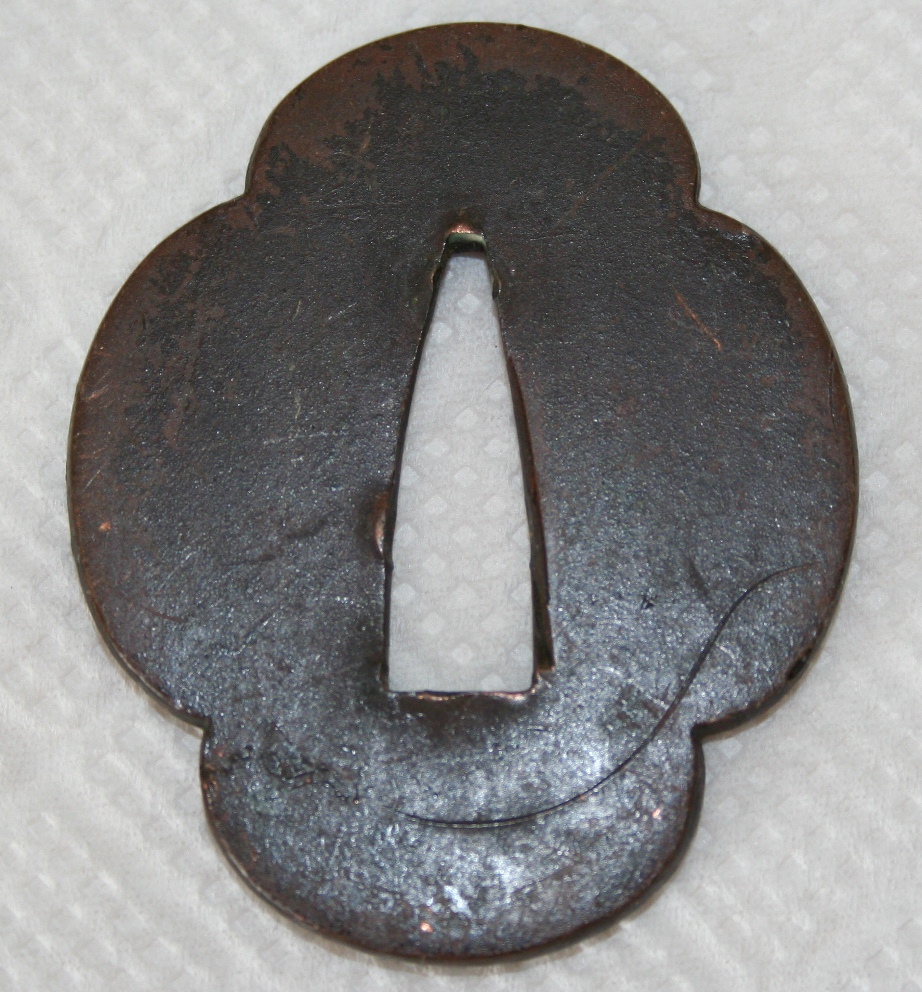

Just wondering what people might make of this iron Tsuba. I was attracted to it and bought it, knowing nothing about it. The dealer said the same thing: Naginata Tsuba. Why does this common perception persist?
7.8 x 7.8 x 0.3  cm
If a tsuba was made for a naginata, I can't see why it would have hitsu ana so perhaps it was re-purposed? Then again, I can't see why a sword tsuba would have a rectangular nakago ana unless it had been fitted and refitted so many times that it was necessary to cut away the metal area with the tagane because it was too fragile. Perhaps the seki gane on this last one would suggest that as the nakago ana could simply have been cut to fit the new blade. All conjecture of course. :dunno:
