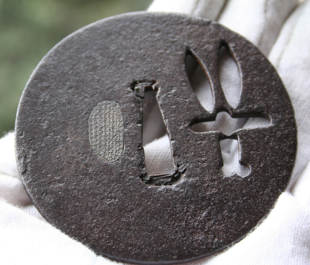

Soshin Posted November 10, 2012 Report Posted November 10, 2012 Hi Everyone, It is a nice weather today for November in Maryland so I did a art photo of what I think is a Ko-Tosho tsuba in my collection. It is unpapered and of average size at 8.0 cm is diameter. The thickness at the rim is 3.0 mm. The ko-sukashi design is of a war fan or gunbai in Japanese. The kozuka-hitsu ana I think was added later to the tsuba. The patina is a bit thin in a few places but overall not that bad and no active rust. The color of the patina that is there is a nice bluish-black characteristic of Tosho tsuba. The rim also displays a fair number of fine tekkotsu and the surface displays the hammer marks (tsuchimei-ji) of the tsuba maker. More photos of this tsuba is on my website. Yours truly, David Stiles Quote
